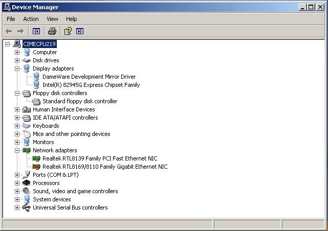

PDMS12.0SP6 is not working in my system

Your attachment does not help in identifying your problem. Could attach the snapshot of the actual error? Also, please check if you sufficient access rights in the installed directory.
Cody Austin
over 13 years ago
You video card doesn't look to be powerful enough. It looks like an onboard Intel graphics card. NVIDIA cards are recommended.
