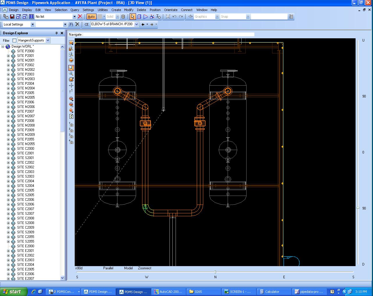

    Can you send a screenshot of PDMS to show what you have in the drawlist?

  • Naresh Tarani
    Naresh Tarani over 14 years ago
  • Thomas Back
    Thomas Back over 14 years ago
    Are there lots of polyhedrons in the hierarchy?
  • Cody Austin
    Cody Austin over 14 years ago
    Can you zoom out so we can see everything please.

    K,Thanks for your reply guys.............my model does not contain not that much polyhedrons  but it contains many sections,equipments with basic primitives and lot of pipe lines .......as i told you it's a big project with many sites and zones............I checked with AUTO clash option OFF
    also but there is no change in perofrmance............
    Sorry for the late reply..............
