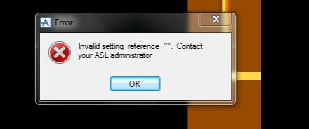

eror code when created handrail, tower ladder and ladder

    Dear corrado,
    I have the same problem,
    I work with PDMS12 since the operating system on my laptop is windows7.
    but none of the components in ASL modeller is loaded except platform,
    can you tell me how can I come over this problem??? "In case of possibility"
    Thanks a bunch
