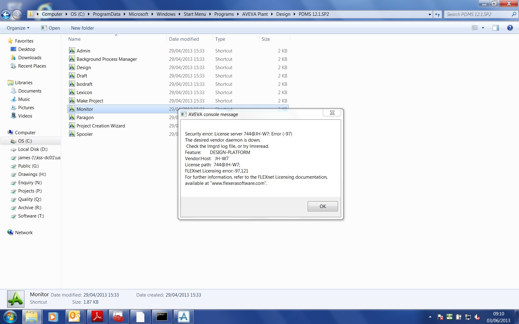

FLEXnet Licensing Error -97,121

hi, try to read the errorlog file, you may get some information from that.
Try to delete the service and create a new instance of FLEXILM service.
me_hungry
over 12 years ago
Also may be useful to check wether any other user use the same IP, as pdms licence serv(JH-V7).
