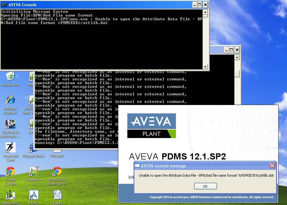

REM set evars for MMS
set pdmsexe=%mms_installed_dir% %pdmsexe%
set pmllib=%mms_installed_dir%\V120\pmllib %pmllib%
set pdmsui=%mms_installed_dir%\V120\pdmsui %pdmsui%
set pdmsdflts=%mms_installed_dir%\V120\pdmsui\dflts %pdmsdflts%
The filename, directory name, or volume label syntax is incorrect.
'--rem' is not recognized as an internal or external command,
operable program or batch file.

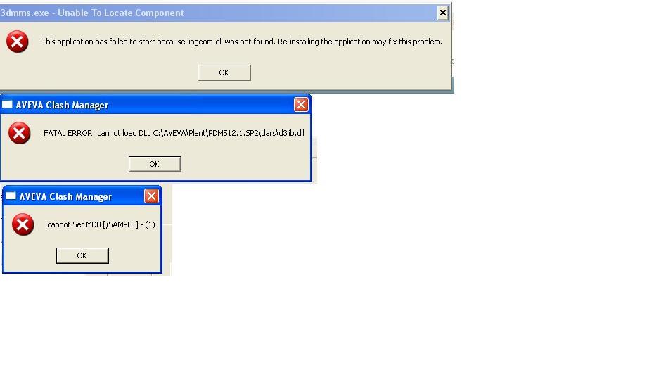

Sorry, cannot find mon.exe within your PDMSEXE - C:\AVEVA\Plant\PDMS12.1.SP2\Cla
shManager C:\AVEVA\Plant\;
Press any key to continue . . .
getting this error message in my console :
set installdir=C:\AVEVA\Plant
set pdms_installed_dir=%installdir%\PDMS12.1.SP2
set mms_installed_dir=%pdms_installed_dir%\ClashManager
set PDMSEXE=%pdms_installed_dir%
set pmllib=%pdms_installed_dir%\pmllib %mms_installed_dir%\V120\pmllib
set pdmsui=%pdms_installed_dir%\pdmsui %mms_installed_dir%\V120\pdmsui
set pdmsdflts=%installdir%\Data12.1.SP2\pdmsui\dflts %mms_installed_dir%\V120\pdmsui\dflts
