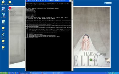

I can enter all modules except design ,whats the reason?
this is the mesage: [COLOR=#cc0000]Application.Exit[/COLOR]
Pedro Valadares
over 11 years ago
Can you please post a screenshot of the black MS-DOS window?
ZZZZ
over 11 years ago
the black MS-DOS :[COLOR=#cc0000]Application.Exit[/COLOR] just that
Venkata Rao Peta
over 11 years ago
With this msg it is difficult to predict the problem.

try to delete all .xml files in your pdms user folder related to design.
q evar |pdmsuser|
the above command will give the path of pdmssuer
