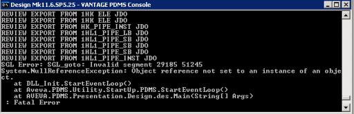

Troubleshooting Sgl error

Sgl error
standy

    SGL stands for Scene Graph Libraries. Something to do with the graphics card. Have you tried exporting on different machine?
    Besides, your PDMS version is older (are you using Windows XP for it?).

    My  macro was working before and for same design data. but now it is not working.
    If I run this macro in graphics mode rather than TTY, then it is ok.
