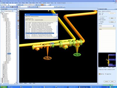

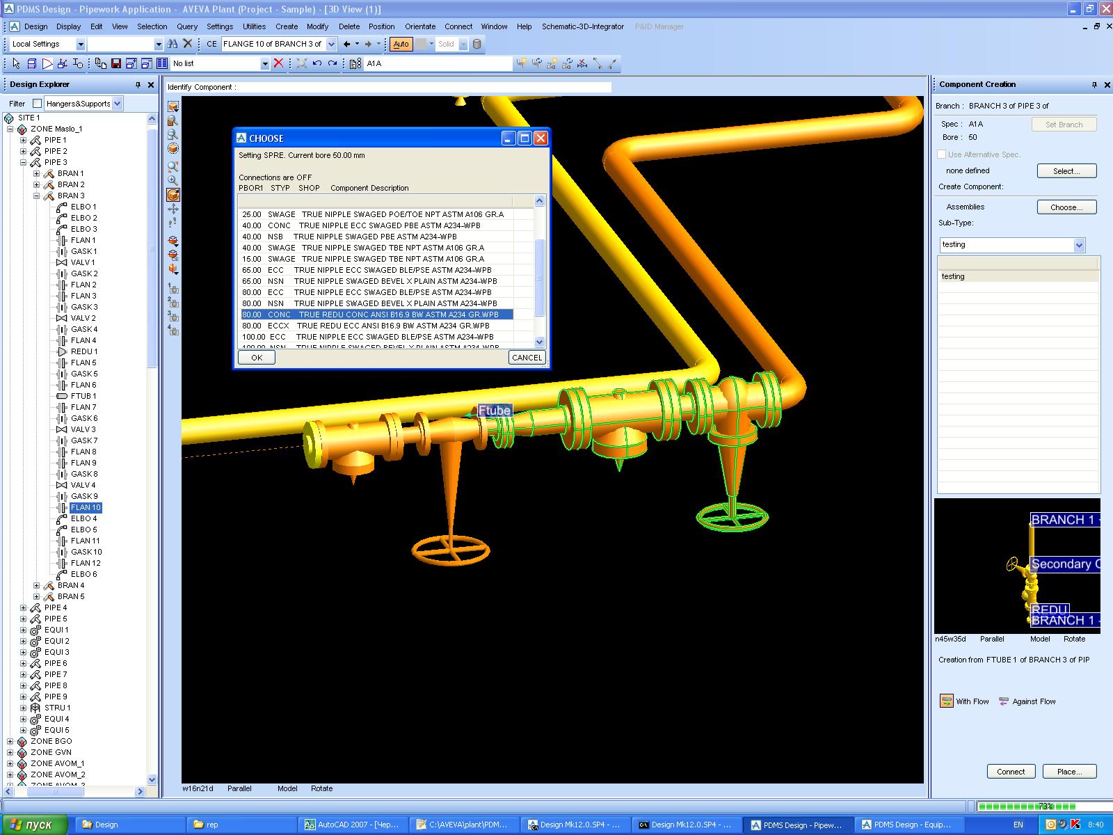

    Ìîæåò áûòü âû òîãäà çíàåòå ïî÷åìó ïðè âñòàâêå Pipe assemblies â BRANCH ïðè íàëè÷èè ïåðåõîäà âñåãäà ïîÿâëÿåòñÿ ôîðìà äëÿ âûáîðà êîìïîíåíòà, õîòÿ ïðè ïîñòðîåíèè Pipe assemblies óæå óêàçûâàåòñÿ êîíêðåòíûé ýëåìåíò, è êðîìå òîãî îïðåäåëåíû äèàìåòðû êàê äî ïåðåõîäà òàê è ïîñëå(â ñëó÷àå êîãäà ïåðåõîä, íàïðèìåð, ìåæäó äâóìÿ ôëàíöàìè )

    Hi, codooaustin.
    Yes, pipe assemblies works.
