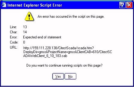

As this is a VBScript, you will need to have sufficient security priviliges in IE to run the code.
You will also need the "Windows Scripting Host" installed (see microsoft website). Without this you will get the error: "ActveX component can't create object: 'Wscript.Shell'"
