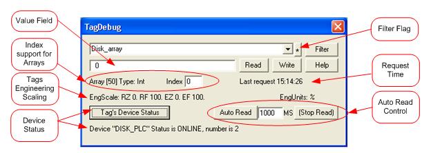

The ZIP below has an extended version of the standard CitectSCADA TagDebug() form. It has cicode variants for versions v6.10, v7 and v7.10 of CitectSCADA. The ZIP includes the help for this. The ZIP file below includes a kit for v7.20 which handles tag extensions. Look in the TagDebug.doc file in the ZIP for more information.
It is intended to assist in commisioning or troubleshooting tags.
