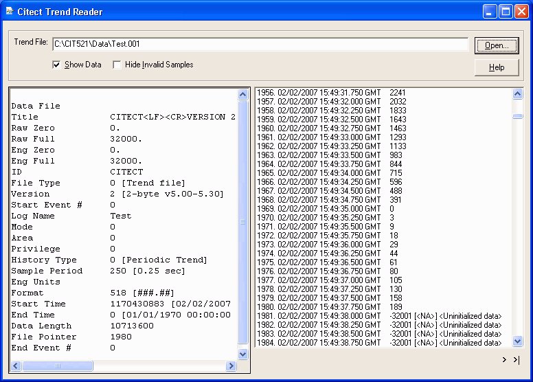

Displays and exports data from Citect trend files
Version
1.02.0008
Requirements
Description
Trend Reader displays all the header fields and data from a trend file. You can display HST files or data files from either 2-byte or 8-byte trends from any Citect release up to and including v7.x.
Run Citect Trend Reader and click the Help button for more information.
VB6 source code is included.
If you get the error "Component 'RICHTX32.OCX' or one of its dependencies not correctly registered: a file is missing or invalid", you may need to download the file RichTx32.zip and unzip it to the folder where TrendReader.exe is installed. If you still have trouble, right-click on TrendReader.exe or its shortcut and choose 'Run as administrator'
