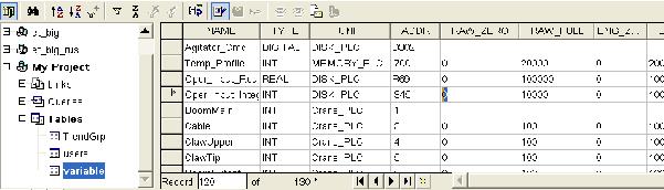

It has dBase capability that you can use in Cicode programming. You can edit your files, add and delete fields, modify filed length and edit the Local language files in Multi-Language Projects. It is free and you can download it from the internet.
You will be able to do those task:
1. Edit the data in a dBase file.
2. Modify the fields in your devices (add/delete fields)
3. Modify field length.
4. Edit the Local language files in Multi-Language Project (in many languages).
You have two way of working:
1) Work in a dBse like window (like MS Access).
2) Work in “Excel” like window.
