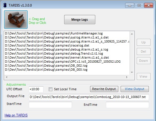

TARDIS - “Time And Reference Display Information System”
Version v1.1
Requirements
Uses .NET 2.0 which should be on all PCs
Description
TARDIS is a utility to merge log files from CitectSCADA v7.20 onwards. i.e. one single composite file is produced which allows the trace flow between process, managed, native code and drivers to be seen as a time ordered sequence. It also accepts ClearSCADA textual log file formats as well.
The utility allows the user to drag and drop SCADA log files onto it, including the crashdump ZIP file. See the instructions in the attached ZIP file.
The format used in v7.20 is :
Year-Month-Day hour:minutes:seconds.milliseconds[Tab][+-]UTC_Offset
e.g.
2010-09-13 14:55:38.236 +10:00 *** Citect process is starting up ***
