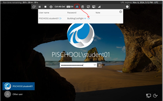

Hello,
The training says I will be emailed passwords for my VMs. However, I have not received an email with these passwords. Does anyone know what the password is to sign in to student01 on PISRV01, for example?
Hello,
Alright I figured it out myself, but I'll post the answer here for those who have this problem in the future. It looks like the move from OSISoft Learning to AVEVA learning means they use a different VM host. On the new VM host (Skytap) no email is sent with a password. Instead you click the "Credentials" icon on top of your VM screen and from there you can insert a password. The training definitely should be updated to match this!
