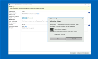

Is it intended that I do not have the SSL Certificate when trying to install AF Server on PISRV01 ?
I am trying to install the AF Server on PISVR01 as per the Hands-On video instruction but when I get to the part of selecting the SSL Certificate there is nothing to select from.
Is this intended ? If not, what to do ? And if it is intended then I could need some guidance.

    Thank you for your anwser, it is what I ended up doing, using the generate a self signed certificate. Alex, in his hands-on video did mention that the certificate was supposed to be provided and in the video we can see that he does select a certificate so I did find it a little misleading.
    Also on the PISVR02 there is a certificate available to select when going through the install.
