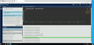

I followed the solution and can't get any data in the trend plot. Anyone had the same issue?
Your x-axis is greatly enlarged, try to zoom in on the left side of your graph. The data provided is more or less a day's worth at most. Alternatively, if you change the search criteria for Time Range to Last 7 Days, it should make it easier to zoom in as required.
A little tutorial on zooming in as well, essentially, just drag over your area of interest.
