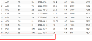

I use symbol to display only the value of the column as shown.
And the values of my row are not displayed.

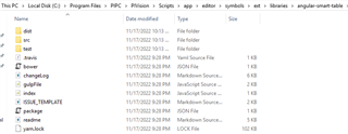

I have downloaded the library but I don't know if symbol has queried the library yet ???

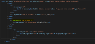

Or my code in the 2 images below has a problem.
