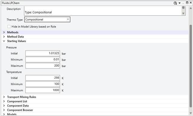

    Yes, you can change the maximum pressure and temperature in the fluid configuration. If you are using a pre-made fluid, just copy it to your local simulation library and make the change there.
    If you are performing simulation in such a high pressure range, make sure to use an appropriate thermo method (an equation-of-state) and consider enabling the high-pressure correction (when available). That will help with supercritical components.

  • Addendum: I also found out the there seems to be an inconsistency in some of the library models, insofar that they don't all use the variable limits from the fluidtype, but have hardcoded values. I will make sure this issue is addressed in an upcoming release of AVEVA Process Simulation.
