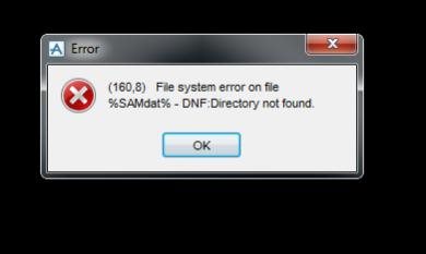

    [QUOTE=sherly;98631]Hi Rafiq,
    Thanks for sharing this macro. I have some issues when i am calling the function. Please see the attached picture here with.[ATTACH=CONFIG]9243[/ATTACH][ATTACH=CONFIG]9244[/ATTACH]
    Please advice me how to resolve.
    You might change some of the code to point to other directory...
    that you need to check.
    if you do so.. make sure  form and the function reflect the changes.

    Hi Rafique,
    Thanks for the sharing. I followed your instructions. But I get the below error. Can you kindly advise what I need to do to correct it?
    pml rehash all
    show !!steeltopdms
    (160,8)   File system error on file %SRFdat% - DNF:Directory not found.
    In line 120 of PML function steeltopdms.LISTDIR
     !this.files = !cnt.files()
    Called from line 91 of PML function steeltopdms.INIT
       !this.listdir()
    Called from line 1 of Command/Form Callback Command
    !this.init()
    Thanks
