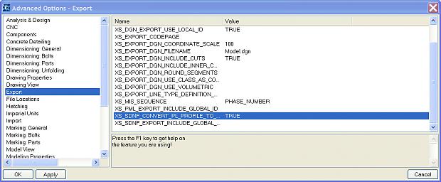

  • Mr.Win Latt Oo
    Mr.Win Latt Oo over 14 years ago
    Dear Neild,
    I just followed as per Mr.rafiquegazali   three snap shot for xsteel export for sdnf. As per you say I need one macro or program for sdnf that need to be install at xsteel. Isn't? If so could you please guide me where can I get this sdnf for xsteel. Thank you so much for your reply.

  • avwf_zplau
    avwf_zplau over 14 years ago
    @test,
    Try selecting first, before the export procedure.
    The bottom right-hand corner of the Tekla application helps to confirm the selection.
    It is very easy to unintentionally deselect if the background is clicked.
