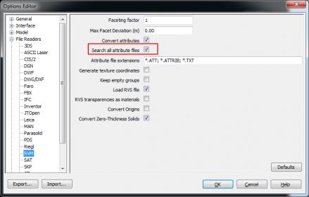

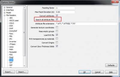

  • me_hungry
    I tried to use the procedure mentioned and successfully exported both the .rvm and .att file in same path with same name
    When I try to open the .rvm file in Naviswork Stimulate 2013 not able to find any of the pdms properties
  • It might wrong extensions of file.
    If you did all things right and put both file in same path, it must be shown.
    review.rvm
    attribute.att
    hth.
