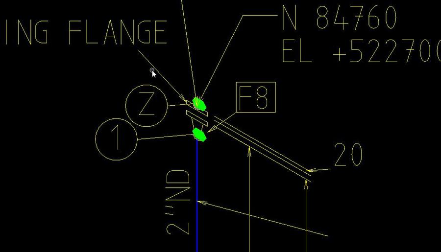

Weld symbol diameter
Sargon Akady
Sargon Akady over 6 years ago
  • Sargon Akady
    Corrado Galluzzi over 6 years ago
    It's the Sphere diameter.
    It's used for "centerline" representaton of the piping (3D model and 2d drawing)

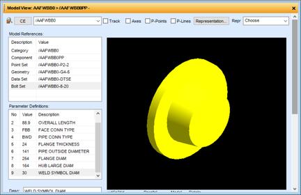

    Thank you Corrado but i wonder how i can calculate or estimate the diameter of the sphere?
  • Azmatulla Mirza Baig
    Azmatulla Mirza Baig over 6 years ago
    Generally the Sphere diameter is kept same as the Pipe Diameter in NB.
    You can refer the Catalogue /00WB200 in the Master project for reference.
    The following weld types have symbols associated with them. They can therefore be shown on isometrics:
    WS Site (erection) weld
    WF Field-fitted weld
    WW Shop (fabrication) weld
    By default, all types of weld are shown on isometrics. You can use the WELDTYPE command to specify that:
    •  Only shop welds will be shown;
    •  Only site welds will be shown;
    •  No welds will be shown;
    •  All welded fittings will be shown as having shop welds.
