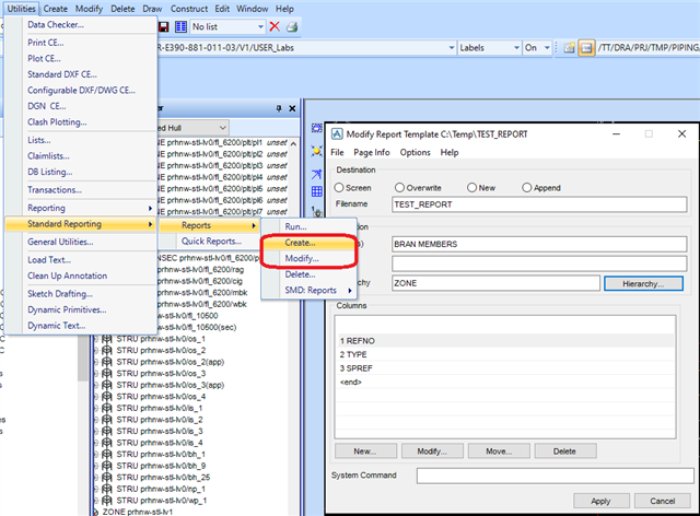

Better to create your own macro that you can just run anytime. Or we have this standard reporting available in PDMS where you can be able to modify or create a new template. You may export your created template and then run it by dragging the exported file into command window to collect the details.
