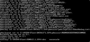

    [QUOTE=trinhnd;108858]Hi,
    Error is still not fixed.
    I have snapshot the console. Anybody please tell me know what is happened ?
    [ATTACH=CONFIG]10728[/ATTACH][ATTACH=CONFIG]10729[/ATTACH]
    That is not the Console window....
    Please post a picture of the Console Windows.
    The reason of your error will be most probably there...
