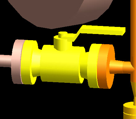

[QUOTE=anhthoichoem;85449]I have the valve, one side it connect with the nozzle and bolt material shall be carbon steel
The other side it connect with the flange and bolt material shall be stainless steel.
i tried many ways but it's not success.
[ATTACH=CONFIG]7412[/ATTACH]
Any one have the tips for this issue?
By the way, i don't know what's exactly Bselector property? why do we need it on design?
one of the solution is the following (using NEW Method)
1. assuming that the CS Bolt is the default material, use the BTYPE 'BOLT' on the valve and nozzle bolts
2. Create the FLANGE SCOM with BTYPE of bolt is not 'BOLT' (example STUD)
3. Create the Bolt Spec with the one with BTYPE 'BOLT' is with CS material and the Other (STUD) with SS material.
we do it this way to some components that do not need user input to change bolt (using BSEL)
