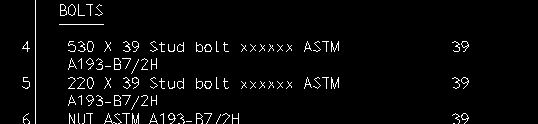

Can we include bolt size in item description of material list just like bolt length.
e.g. "[COLOR=#ff0000]
1/2" X 75
[/COLOR]Stud bolt xxxxxxxxxxxxxxxxxxxxxxxxxxxxxxxxx"

You have to use this setting in Isodraft option file :
Bolting length description ON INSERT at 'BOLTLEN'
and e.g. rtex in paragon is:
Rtext '1/2" x BOLTLEN BOLT STUD WITH 2 HEAVEY NUTS,WITH 2 WASHER,ASTM A193GR.B8M/ASTM A194GR.8M'

That mean automatic bolt size can not be called in item description.
