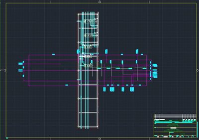

    Sorry for the bad spelling, in the order of failures:
    came, always

    Ah, version:
    AVEVA Everything3D Draw Mk1.1.0.19[11903]  (WINDOWS-NT 6.1)

    [QUOTE=scho2684;103228]Ah, version:
    You should try to keep your installation as much updated as possible.
    Recent Fix releases have addressed several dxf/dwg output issues/enhancements
    That's probably why mno has reported no problems
    Corrado Galluzzi over 8 years ago
    Unfortunately Fix 30 gives no solution to the posted issue.
    Thank you.
    I have checked internally.
    There is a Support Incident opened about that.
    It will be fixed in the short future.
    No problems reported on E3D 2.1

    I tested on E3D 2.1 fix 5 and E3D 1.1 fix 30, and I was not able to recreate the error in either of these versions.

    Gents,
    Thanks for the response so far..
    We have not found this issue with version 2.1 however as a big company we are not just jumping over to this version.
    There is too much risk, we are just about to roll out 1.1 we need to test all our appware to see where we need changes.
    A very big issue might be the STL profiles, we have our own catalogue for reasons, we have to investigate yet what the impact would be.
    Although already stated that fix 30 is not solving the issue, I will try it none the less since mno had apparently a good result.
    The policy is that we roll out 1.1, so I must find a solution for this.
    Its obviously Murphy's law that something seldom is used, will be used on the very first project we do...
    Any thoughts on how to orientate the view using the UI in stead of the commandline syntax?
    I digged trough the manuals but was not able to find it...
    Right mouse click does rotate all the annotation though (except the dim's) which is a bit absurd...
