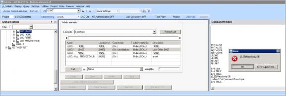

    Dear Expert
    In module ADMIN at SATELLITE I have tried to INITIALISE the new LOCATION from --> PROJECT -->Initialise Location
    then I have exit and re-enter but the NEW lOCATION is not yet initialised.
    in the command window i give the comand :
    Q LNIT
    result LNIT FALSE
    then I have tried to modify in command window
    LNIT TRUE
    but i have this message = (2,25) Read only DB
    the TRANS database of this LOCATION is PRIMARY
    what this means ?

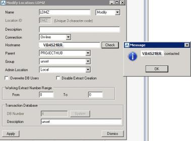

  • Manuela Rodriguez
    Manuela Rodriguez over 9 years ago
  • Manuela Rodriguez
    Sorry....where I have to add the IP in HOST file ? have you and image as example ?

  • m_pdms
    m_pdms over 9 years ago
    IP address adding is mandatory if the Global connection is established by a SSL VPN.....
    Are you using any VPN to bypass the firewall.....
    if not IP address adding is not required....
    As the communication is one way I suppose the satellite port opened is not reading the required IP address or the required port at satellite  is not opened..... check with HUB requirement to open the ports.....
    what is the Global setup is it RPC or WCF?
