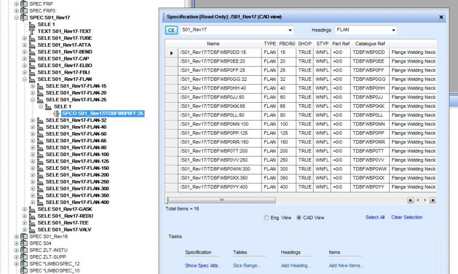

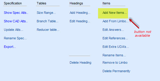

    Hi,
    I am trying to add new component to an existing spec but the problem is it "read-only" and the "add new items" button is not working.
    I tried fixing why this particular specification is read only. checked the attributes, tried  the "lock-unlock" in the modify menu, even went to admin mode just to check if the database is locked but to no avail.
    Have you had similar issues before? Hope anyone could help.
