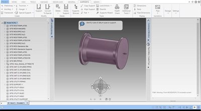

Support not place

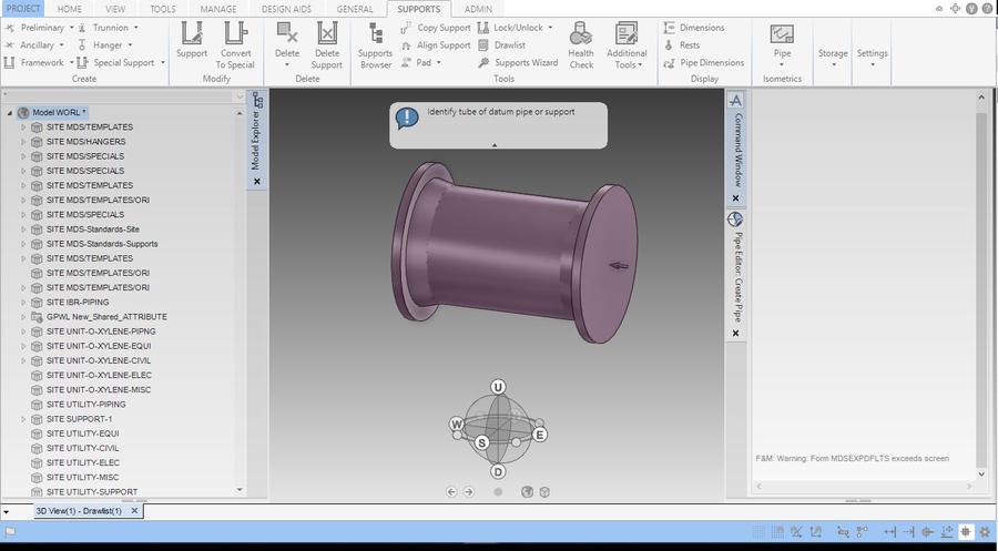

    But not working this. Moreover, I copied one line from xxxx project and paste in yyyy project with same spec ,  same data but support not placed.  May be, I missed any procedure to Install MDS Support in E3D ?
    Yes it could be possible.
    Which procedure are you following?
    From the documentation:
    The Pipe Specification Material Code value, for example, CS, represents the setting stored at a valid Pipe
    specification, at the UDA :MDSPipeMat, for use by the Supports discipline.
  • Amit Prajapati
    Amit Prajapati over 4 years ago
    [QUOTE=corrado;119010]Yes it could be possible.
    Thanks Mr. Corrdo.
    I changed :MDSPIPEMAT . Before it's unset and after your answer I changed as CS.
    It is working.
