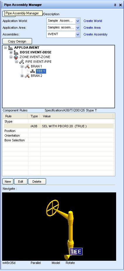

    one  more question.
    If you see earlier snap,
    i have have set rule for TEE for Position ''dist 100'' . but when i want to use that assembly in design, it will not crate new assembly branch with ''dist 100''.
    You can read C:\AVEVA\Plant\PDMS12.0.SP6\Manuals\Docs\Pipework Design User Guide.pdf Chapter 12.3.5 Piping Assembly Component Rules.
    Among other things it says: Positioning - DIST 200 FROM PREV
    HTH
    Same manual, same chapter as above.
    You can create "Selection Rules".
    I.e. SEL WITH PBOR3 20

    Is there a way to "FORCE" the Tee Piece in such assemblies, ie default it to an e.g YYmmx20mm tee-Piece. In other words users are not given the option to select the Tee Piece from the Catalog and hence make selection errors ?

    [QUOTE=sconvens;75442][ATTACH=CONFIG]6354[/ATTACH]Have you tried this, Corrado? As attached does not seem to do the trick for us.
    In addition, How would you define two selection? "SEL WITH PPBOR3 20 and STYPE T" ? or "SEL WITH PPBOR3 20 and SEL WITH STYPE T" ?
    I am sorry sconvens....
    I thought it would have been straightforward....but it is not! :-(
    I will meditate about that.....and if I will find a solution I will come back to you....
