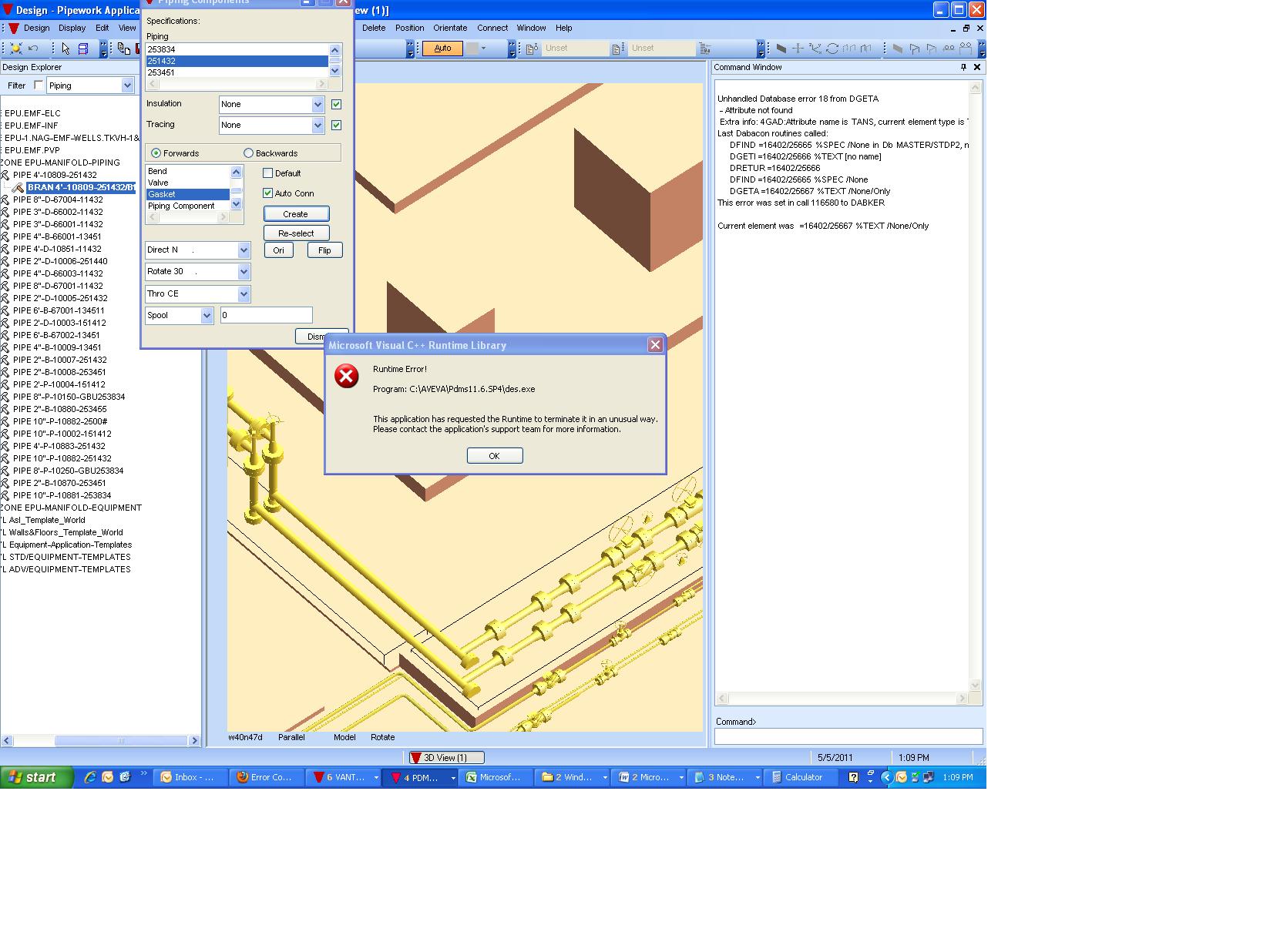

• You should check the elements called =16402/22665, =16402/22666 and =16402/22667 as from your jpeg images. DB number 18 (16402-8192-8192=18)
    Could they be SPEC selectors elements?
    In the past I had problem with SELE elements with no members.
    Try to delete them. (quick report filter: MCOUNT EQ 0)

  • [QUOTE=corrado;50931]You should check the elements called =16402/22665, =16402/22666 and =16402/22667 as from your jpeg images. DB number 18 (16402-8192-8192=18)
    Corrado,
    thanks it works fine with deletion of =16402/22665, =16402/22666. they are selectors with null setting and spec. they must be virus or what can I call them?
    thanks again.
