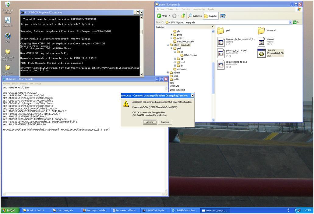

Where you placed your project? All disks for PDMS dbs need to be as NTFS not FAT32. If you use proper format check all environments for project and PDMSUI pmllib and so on.
PDMS 11.6 is not Vista compatible and is not supported. PDMS 12.1 will be when it is released.
