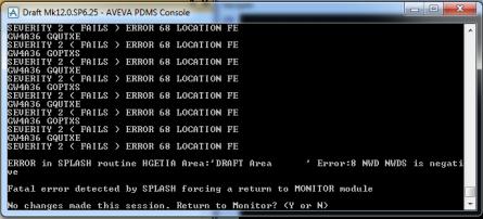

Error when i add sheet
Gaurav S. Naik
Gaurav S. Naik over 10 years ago
  • Admin
    Admin over 10 years ago
    Hire a good  admin he can resolve your errors:angel:
    First error (Severity.....) is due to the fact that you do not have True Type Fonts installed for your project.
    But this  usually doesn't stop you entering Draft.
    Second error....
    You should run DICE (Database Integrity Checker) from the SDMIN module and see if you have any critical error in your Padd Database(s)
    ADMIN module I meant...

    ok sure i will try this....
    but when i enter in monitor module (' Variable !!cdrcadcga1 is not exits.' ) this error occurs wht does it mean..

    hii
        I generated the DICE report this below error occurs can you suggest me any solution for it
    (Warning- Attribute SHRF contains invalid ref)
    (Warning- Attribute NOTF contains invalid ref)
