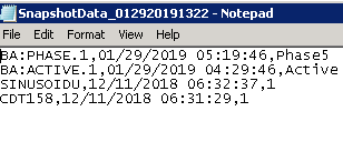

    Input file :
    Snapshot Output :
    If your requirement is to generate the .csv file every day then you can specify start and end time.
