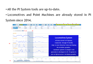

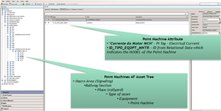

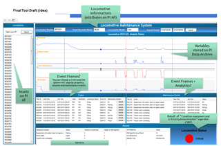

    You can see the pictures below, which explain a little bit about my objectives.
    About the Locomotives CBM, the firstl goal is very simple. The algorithms are not complex so, I believe, the suite AF+Analysis+EF+Notifications will be capable to perform all the operations.

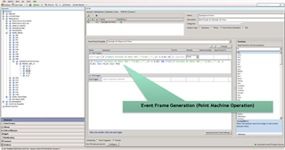

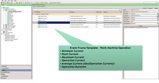

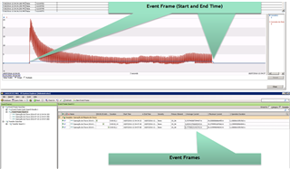

    About the Point Machines, the first step is only identify the operation and calculate three parameters - max current, operation duration and operation current (I have a problem to identify that - see (PI Formula - Disregarding the first 2 seconds of an Event Frame). But the real gain would be the implementation of intelligent logic using, in fact, machine learning, neural networks, and others, implementing preventive maintenance.
    Maybe I can creat a specific topic here in forum to discuss about that. What do you think?
    1) Locomotives
    2) Point Machines
